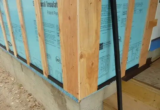

In order to turn this into a comfortable space, you will need to insulate the structure. The most cost effective way would be to insulate it from the outside, and then cover it up with siding.
To start, you can use sheets of XPS (expanded polystyrene) foam to cover the entire outside. Tongue and groove sheets would give the best fit since there are fewer gaps. The XPS sheets can be attached directly to the wall using a construction adhesive which is specifically made for foam. You can't use most other adhesives because they will have a chemical reaction to the foam and burn holes through it. The foam will take some time to adhere, so you will need to use temporary bracing to hold it tight.
After the insulation is installed, you would need to cover it all up with siding to protect it. The foam itself is not designed to be exposed to the elements. Exposure to UV rays will break it down very quickly. To install the siding, you will need to install furring strips to nail the siding to. It would look similar to the image below. You can look at this site on how to install vinyl siding.
Siding Prep
The roof is another concern, you may need to have an entire new roof put on that is properly vented. You should take a look at Adam Davis' answer for tips on roof design.
