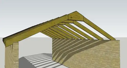

I built my 12x10 shed by using 4' by ~18" OSB gussets at the peak of each 2x4 rafter set, essentially resulting in a truss, which proved very solid:
Source: http://halbergengineering.blogspot.com/2010/10/structural-engineering-for-minnesota.html
