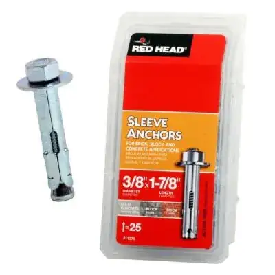

Most masonry anchors are sleeve anchors and use bolts (also called machine screws) to expand the anchor.
sleeve

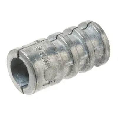

There are also metal lag shields that use lag bolts (heavy duty screws) to push outward on the hole and hold the device. These are fairly reliable, but are less forgiving if you need to remove and reinsert the bolt.
lag shield

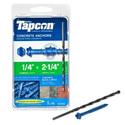

There are also masonry screws that can hold in concrete without a separate anchor, but these need precise drilling and care when tightening to prevent stripping the hole. While they are fine for things that use numerous attachment points, such as studs in a concrete floor or wall, the risk of failure on a device that only uses a few mounting points make these a bit more risky (in my view - contrary points of view welcome!).
tapcon
