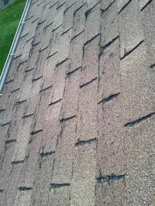

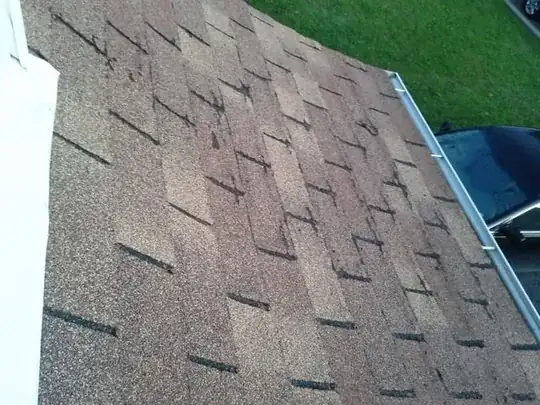

I don't know how long ago this roof was shingled, but we've noticed that the asphalt shingles, in two patches, have begun to curl and lose their grit.
Even after a late summer of fierce rain, at least for now, there is no evidence of water infiltration within the home (no mould, staining, drooping drywall, bubbling paint, etc).
How long can we wait until replacing the roof? Given the budget, should it be done urgently?
If it is necessary, but we can't get it done before the snow falls (which will be soon) are there any stop-gap measures we could try?
First view of part of troubled roof shingles with gutter
Second view of part of troubled roof shingles with gutter.

Replace it now. Like TODAY. That's BAD.
With that kind of bad shingle wear, your shingles are likely to create ice dams which will cause water to back up and leak through the roof, causing interior damage, compounding the cost.
In the summer, the roof won't hold the water because it can't freeze, so the curls will only grab a very little water before it drips free.
In the winter, however, a little retained water will freeze, expand, and capture more water, which will freeze, and so forth.
The Evil Greebo
  • 25,971
  • 91
  • 125
Don't worry about how long, that roof is very long past expired. If you can, get the shingles stripped and a new roof, ASAP, do so.
Patches will offer little in the way of prevention against precipitation mishap. Your best "friend" will likely be a very persistent cold season...at least until thaw. That is, if your attic is well insulated and well vented to keep it cold in there (and not melting snow on top). Well organized roofers can do a reroof even with nitetime precipitation, if not too heavy. So get crackin'
