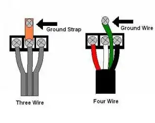

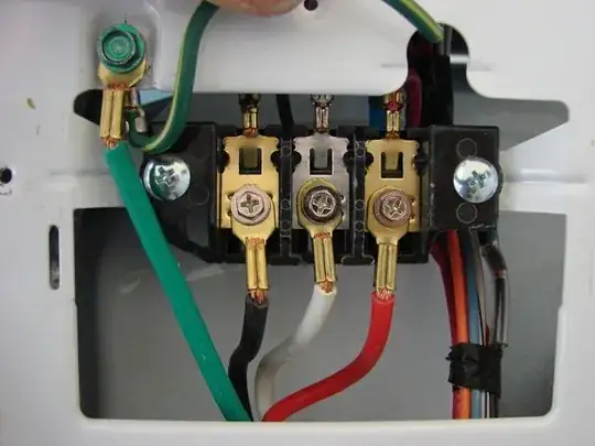

The terminal block on the back of your dryer should have connections for the neutral and both hot conductors from the dryer cord, plus a separate grounding lug for the grounding wire. The grounding lug is bonding the metal housing of your dryer to the ground. Make sure you leave any green grounding wires on the dryer itself connected, as well.
What you do NOT want to do is connect the ground wire to the neutral lug on the terminal block if there is a separate grounding lug.
Although; depending on your dryer (or if you have an older dryer), there may be a grounding strap connecting the neutral lug to the metal housing of the dryer. If this is the case, you can presume that the dryer was designed to use the neutral as a ground path and connect both the neutral and grounding wires to the neutral/grounding lug. But you still might want to call an electrician and get some local professional advice or have them do the work, especially if it's an old dryer.

Make your connections tight. Loose connections get hot and start fires.
