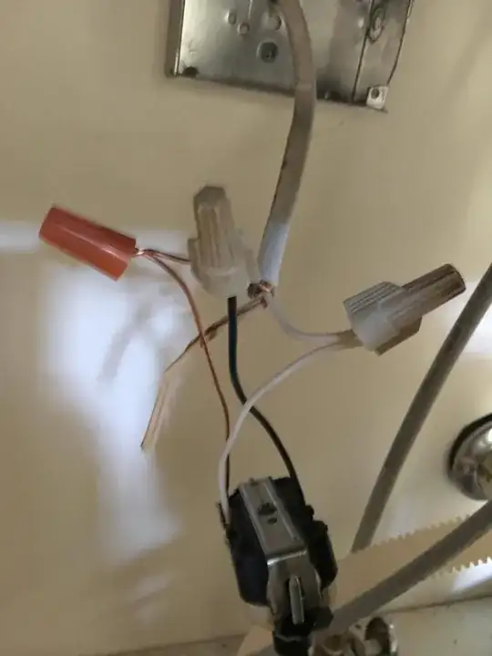

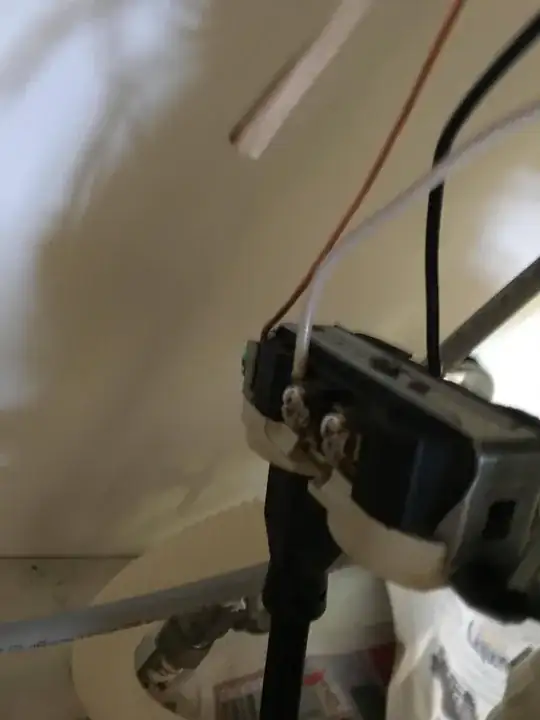

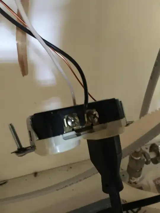

As requested, here are some pics of the wiring as it is now, pigtailed into an outlet. The GFCI outlet was the same as this except I wired it directly to the cable coming out of the wall, and used the terminals that weren't blocked out by the yellow LOAD sticker.
pigtails
silver side posts"
brass side posts
