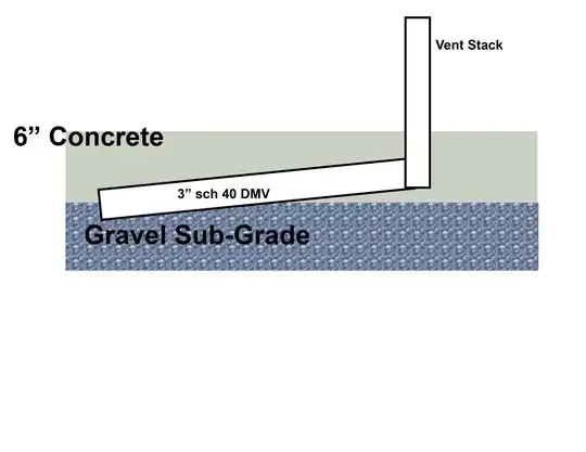

I have an unfortunate "this is the only way this is going to work" situation with a DWV repair, resulting in the repair portion of the drain pipe, having to run 4 feet horizontally (yes, at the correct slope of 1/4"/ft) before turning up into the main vent stack...mostly above the gravel sub-grade and tapering into being completely within the 6" horizontal space where the concrete slab will be repoured.
My question is, can 3" Schedule 40 PVC pipe be directly embedded in concrete? Not covered by, or under, but directly embedded (concrete will fully encase 4ft of the pipe). I'm wondering if the heat of curing will warp/crush the pipe? I know horizontal stub-outs come through a concrete slab all of the time with no issue, but I'm not seeing a lot of examples of horizontal embedding. I'm sure there are other ways to do this without the last-ditch option of embedding PVC horizontally in concrete, but those involve a 5-figure $$ removal of the entire basement slab and replacement of every single pipe.....just to get that 4' run of PVC encased completely in the gravel sub grade.
The attached photo is a very poor rendition of what's going on here, not to scale, best a non-computer person could do! not to scale drawing

PVC pipe embedded in concrete should be fine under most codes I've seen. You'd need to sleeve something like black, galvanized, or no-hub iron pipe, but PVC and ABS are impervious on any reasonable timeline (~hundreds of years.)
You could have your inspector come through before the pour to check out your plumbing permit if needed.

It's common practice to place PVC sleeves through concrete footings, foundations, and slabs for immediate and future use. I've used them in many ICF foundations, and they're regularly used to protect drain tile in footings and pipe through basement slabs, for example.
PVC pipe is known to be stable to at least 140°F. Beyond that it starts to soften, but curing concrete will not approach that temperature in normal circumstances. Even if it did, the concrete will be stable enough by that time that crushing is not a concern.
