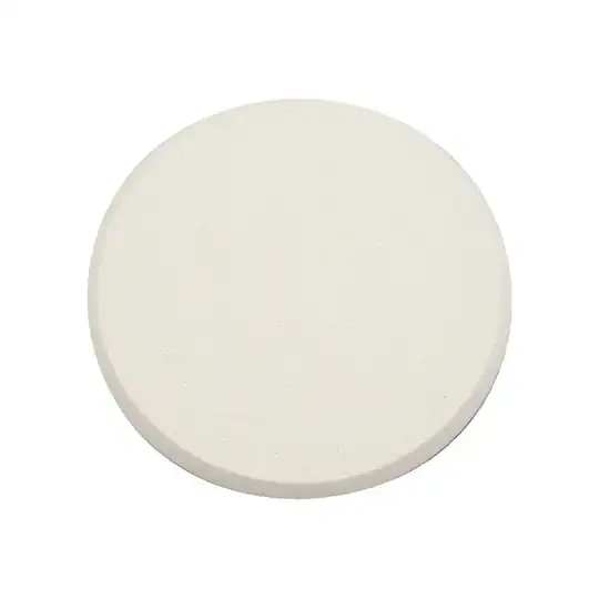

Forget about making it perfect - just get it flat enough, to put a protector on the wall, and call it a day. If it knocked out once, it will get knocked out again, and again and again...
Vinyl wall protectors are cheap, and last a lifetime - you can even get them in different colors, online, and in some stores. I use them in hallways (linen closet door), and children's rooms, where a hole in the wall is eminent, if not already existent.
