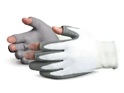

Get a bulk pack of cheap mechanics gloves. Take a few pair and cut the fingers off until they look like these expensive ones.
(source)
I cut all the fingers off, but be sure they still cover your second knuckle. That's about all they're for; to protect your knuckles against the sharp edges of J-boxes, and having a cover on your palm while you payout wire.
Note, these only alleviate abrasions and in no way will they protect you from electrical hazards.
