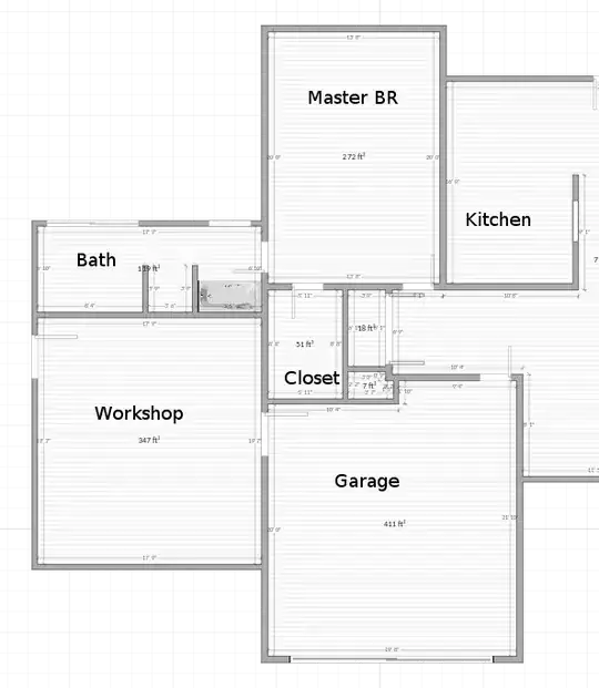

I'm also planning a renovation of the house with an addition, which will expand the attic space and may change the requirements for attic flooring. For thoroughness, here is a floorplan of the space below the attic area I want to finish prior to the renovations: pre-renovation
The span between the outer wall (left-most wall) and the rightmost kitchen wall is ~24 feet. The converted space would stop there, and would only be as wide as the garage for the area above the garage. Ceiling joists are currently strung left to right in these floorplans.

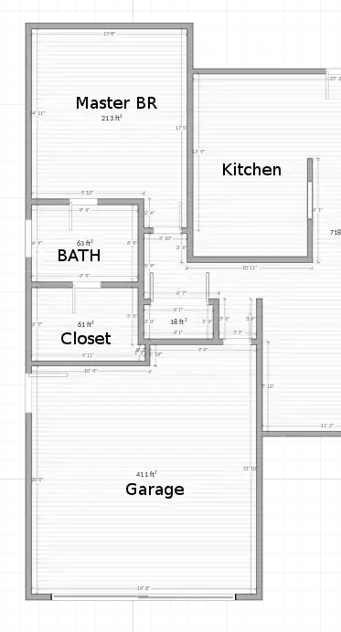

Post-renovation, here is the floorplan: post-renovation
The master bathroom is conditioned space, the workshop will most likely be slab, unconditioned space. The space above the new master bathroom would not be converted to living space, the space above the workshop would.
