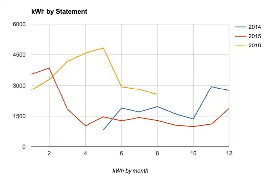

I've already visited this similar, but different question and saw a commenter mention that about 500W seems appropriate for blower fan of an HVAC system. The past few months we've had high electricity bills compared to the same period last year (lived here 2.5 years), but it's also been a hot summer. I've plotted the kWh that have appeared on my statements (for science!); the increase begins in March.

Since it's summer and our system's fan is set to ON to improve circulation, I have to assume this is the blower fan's motor. When we're away at work or vacation and even I've made a point to power down everything that can be powered down, I still have the 1.7 - 1.8kW draw. Someone please check my math, but over 30 days, that 1.7kW load comes out to 1,224kWh. This amounts to about 1/2 of my monthly electricity bill, which was 2,550kWh last billing cycle (the previous year at the same time it was 1,290kWh).
