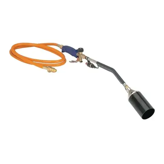

You could try reheating and maybe add a little asphalt patch. For pavement on the ground, serious heat is called for, perhaps something like this: Harbor Freight propane torch with igniter 91037
I would use a shop vac to thoroughly blow or vacuum the dust and grit out of the gap before heating.
