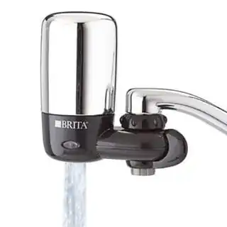

Ideally, I would be able to install some sort of faucet-mounted filter (similar to the image below) that could add safe levels of fluoride to my tap water. Presumably this device would need to be refilled or replaced once in a while. Unfortunately, I suspect that this type of device probably does not exist.
Does a device like this exist? If not, do I have any other options for adding fluoride to my tap water?
I rent an apartment and I am not permitted to make permanent changes to my plumbing. I would prefer options that involve minimal / reversible modifications such as a faucet mounted filter (i.e. solutions that won't upset landlord).
