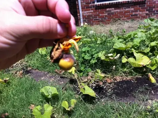

I'm getting plenty of flowers, and about half of them produce a tiny little pumpkin.
However, after only a couple of days, the pumpkins begin to turn black and shrivel up.
It is 104-degrees during the day with medium humidity.
I have been providing water.
Although my sample size may be a tad small, it seems that those in the shade are slightly more likely to survive.
Should I cover the young pumpkins to give them a chance?
I have 8 larger pumpkins in the patch, but I haven't had any new ones take hold a while.

With 104°F temperatures and especially if your pumpkins are in full sun, that is the most likely cause of what you're seeing.
Also did you allow the patch to dry out during that extremely hot period?
If yes, that would also have had an affect on what you are now seeing.
  • Pumpkins, especially early on when fruit is being set, benefit greatly from some protection from the full midday sun (especially when taking into account the kind of temperature you gave) ie Think shade covers.
  • Pumpkins are heavy feeds, plenty of organic matter and fertiliser (if you can't get enough good quality organic matter).
  • Pumpkins do better with a good constant water supply. You don't want to be drowning them, but keeping the soil constantly moist below the surface, greatly helps keep them happy. It's better to water at soil level, instead of from above. Drought, drying out of the soil can really stress your pumpkin patch.
  • Pumpkins like and need a lot of space, and also like their patch weed-free as much as possible. Careful, regular, hoeing of your pumpkin patch is a worthwhile job, your pumpkins will thank you for it. Added benefit of keeping your patch as clean as possible = Greatly reduces the risk of pests/disease taking hold.

Judging from the latest photos you have posted, which show that the entire plant has yellowed, and the leaves have wilted, I suspect that the problem could be caused by the fungus Fusarium Crown Rot, which has not yet spread to your other pumpkins, as outbreaks tend to be localized; the symptoms develop as follows:
  • Initially, the leaves and stem turn yellow
  • Over the next 2-3 weeks, the entire plant wilts, collapses and decays.
Apparently, damage to the fruit varies widely,depending on the particular pathogen involved. It is worth examining the stems carefully, since a black and rotting area, at or just below the soil line, is characteristic of this disease, and together with the above symptoms, would definitely suggest FCR.
I hope this tentative diagnosis prove wrong, as its spores can survive in the soil for 2-3 years and, unfortunately, there is no way of controlling it other than by a four-year rotation.
You will find most of this information about FCR, together with details of similar diseases, here and here
