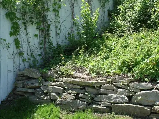

  • Picked a location in the garden.
Location for compost pile in a garden

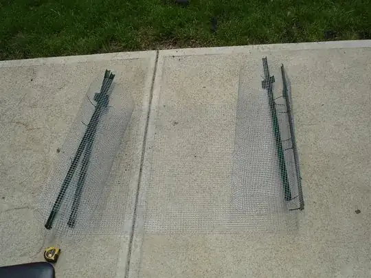

  • Assembled a simple three sided structure (see below photo) using the above mentioned materials.
Assembled, a simple three sided hardware cloth compost pen

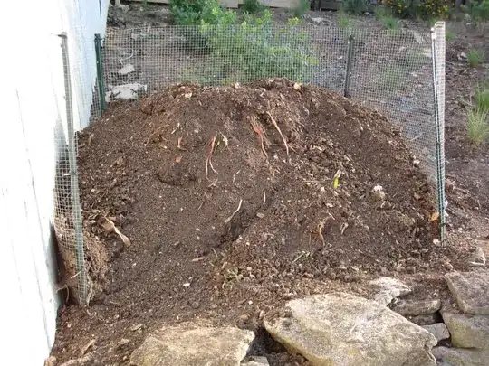

  • Installed the simple three sided structure in the location picked out previously.
Installed, a simple three sided hardware cloth compost pen

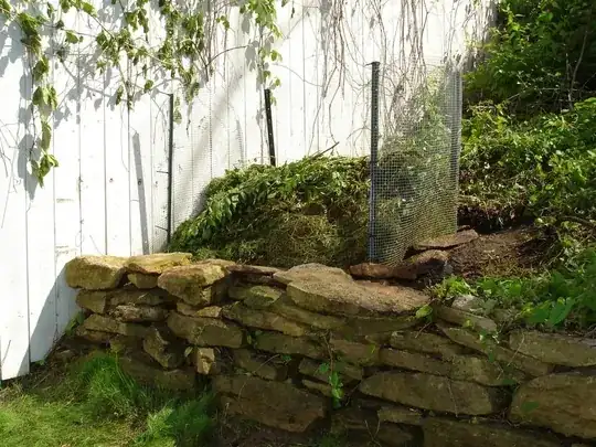

  • And here is the same compost pile 3 years later (photo taken today).
A simple three sided hardware cloth compost pen
