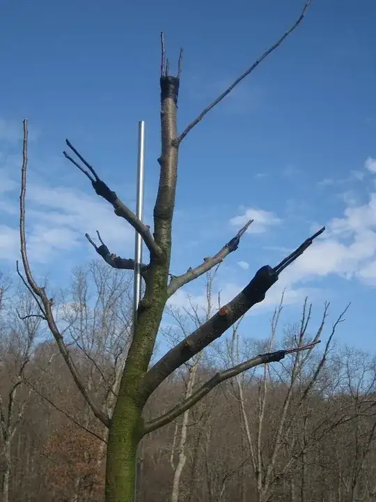

If you are comfortable with rind grafting (pictured below), Then yes, these trees are compatible. This is best done in early spring just before bud break. Be sure you leave some original growth, to support the whole thing while the grafts take. This is the method used for changing larger trees for different fruit. The picture below is from an apple tree, which is one of the easier trees to graft. Oranges will be tougher, as the scions aren't deciduous, and will tend to transpire too much.
