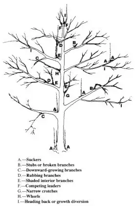

Of the descriptions about renovating mature fruit trees this seemed useful: Fedco Trees Tips for Renovating Old Apple Trees
These images show trees that are fuller than the ones I am dealing with:

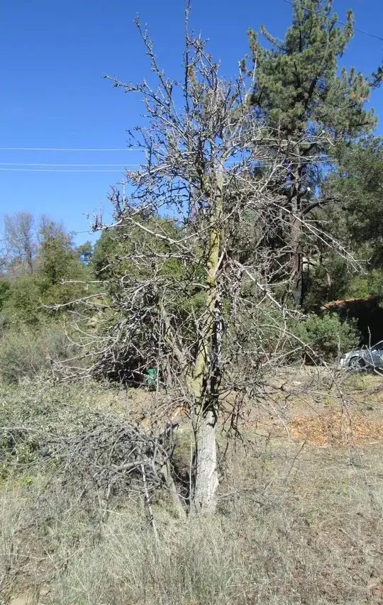

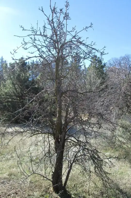

The example tree shown in the images below is 16' tall.
View of mature pear tree - south side View of mature pear tree - north side

  1. Remove the suckers.
  2. Remove the dead wood You can check by bending the tips. If they flex easily, it's still live. You can also scrape the bark. If you find it green, that part is live. If bark flakes off, it's dead.
  3. Step back. Remove any branches that cross. Remove any branches other than the leader that run mostly straight up.
  4. Cut the leader off at 12 feet up, or whatever length you decide on.
That's it for this year.
Year two: Continue to open up the interior of the tree. Watch for bursts of twiggy growth at the cut branches from last year.
During this year watch for symptoms of fireblight.
Put down a layer of cardboard under the entire expanse of the tree, to about 4 feet beyond the drip line. Apply 3-4 inches of wood chip mulch (Ask the local tree trimmers -- they love not having to haul it to the dump. Assuming you have a wet season, this will hold the moisture through the dry season.

Well, (for the example tree) I'd start with taking off the suckers, and any dead wood, because they are relatively easy to identify, and it's hard to tell what's going on with that tree to figure out what to cut next. Maybe that would BE the first year's cutting (and removing any new suckers/"watersprouts" would be the start of next years cutting.)
I have no personal experience with arid growing, but some of my idle reading would suggest that you might want to mulch around the tree rather than have the grass growing there, from a water competition point of view.
