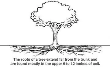

The roots of most trees are shallow (i.e., not more than 1' to 1.5' deep), but spread out very wide (see the picture below from here) . Given the height of your trees, they're not very young and you can be sure that the roots spread at least as far out as the tree is tall. Add a factor of half to that for every 10 years of the tree's life. Note that this is only a rough approximation and if you need a better estimate, you'll have to contact an arborist.
