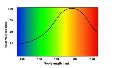

My summary of the various information sources would go something like:
  • Light outside the range 400 to 700 nm is less useful.
    • As all the light shown below is in the 400-700 range you are not spoilt for choice.
  • All light in the range is useful but
    • that in the middle may be somewhat less so
    • that at the right hand end may perhaps be slightly more so

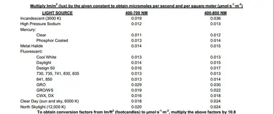

    • Despite containing some unfortunate "jargon" both the Sylvania reference mentioned below and the related Wikipedia page both contain tables with conversions factors to derive PAR Watts from more standard measures.
  • Enjoy
Here is a chart of conversion factors from the Sylvania reference:
Larger version here

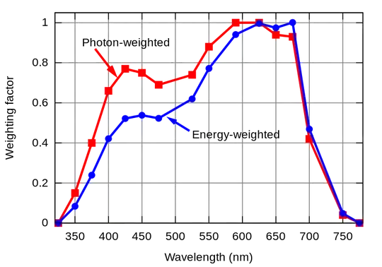

PAR refers to light which is photosynthetically useful.
Wikipedia has things to say about it. From there:
This graph purports to show you what matters.
Essentially, any light between 400 and 700 nm is useful and light towards the 700 nm (red) end is somewhat more so.

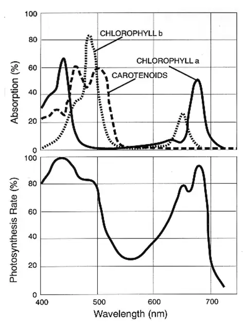

However, also from there are these two graphs. The lower one is very roughly equivalent to the one above BUT it has a deepish central dip AND the top one below shows you why.
Real lighting people like Sylvania weigh in with mumbo jumbo like this which while it is useful and does give some insights also (for my liking) leans too far towards the enjargoned-mystical. eg measuring photons in units of mols because the quantity can be divided by 6.023 x 1-^23 (Avogadro's number) is about as meaningful as measuring the quantity of sandflies present in units of years because they can be divided by 365.
