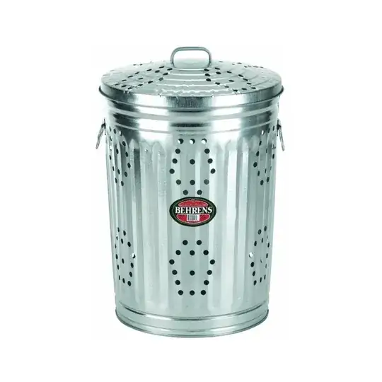

Is this compost bin rodent-proof?
If not, how to find a similar but rodent-proof or at least relatively safe one in that regard?
I want put put a compost bin in my backyard and put my food waste (mostly vegetable scraps without oily content) in it to create a compost and use it for my garden.

Yes, rodents shouldn't be a problem with a bin like this, if you set it on something. Mice might be able to get through those holes, but I'd just set it on three cinder blocks, to keep it up off the ground. You won't be able to get a super hot compost going in such a small space, but you can certainly can get some batches done in there.
I wouldn't be surprised if mice won't be a problem, either. I think squirrels (if they're in your area) will probably check it out, and possibly try to pull stuff out through the holes, but that will be the case with any composter.
Also, If you get a lot of precipitation in your area (like over 30"/year), and are going to be composting a lot of kitchen scraps, cover the holes in the lid, or it will get too wet and decompose anaerobically, creating a smelly, slimy mess.

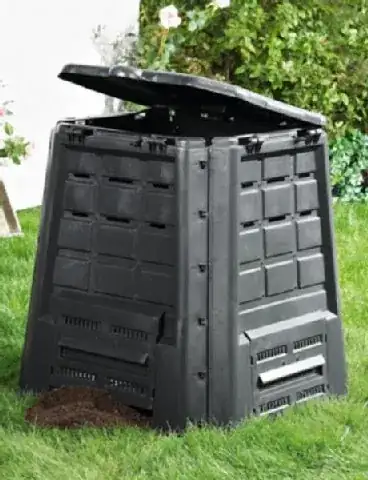

On a small yard I'd rather use a compost container of this kind:
(image stolen from here)
It is made for (quick) composting. A dedicated object instead of your more universal product (can be used for burning waste as well). I have no personal experience with such a bin, my parents in law are using several of those on their small backyard and are very happy with it.
As to rodents or wildlife in general: a compost pile, even a closed one, will attract all kind of wild-life (they actually do the composting process) - rodents included. It is at least the smell which make them come by. Whether they stay or not depends also on what you put on the compost. Rule number one: no meat and avoid cooked stuff.
UPDATE: @anderas is right, the floor is open (to help worms get in, though they will their way in even with the one you have).
The other difference with the one you have shown is that this version has an opening on the side close to the ground where you can gather finished compost.
