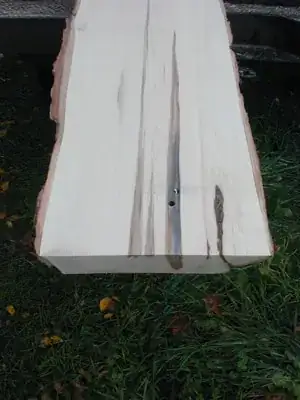

This image from northernwoodlands.org shows a board with a visible taphole and several visible stains (the tapered dark areas.) You can see that a good deal of new white wood has grown over the two stains to the left of the hole as the tree continued to grow. Even the stain with the hole has been grown over, but it was some years (and tree-growth rings) later than the other two. As a general guide, you never want to tap directly above or below a visible old tap hole. taphole in board from northernwoodlands
