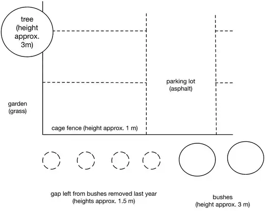

UPDATE: Here is a sketch of the situation. An ashed rectangle indicates the approx. size of a car. It's visitor parking space and usually not all slots are taken. Up is East. I thought it would be nice to plant a magnolia tree close to the corner of the parking lot (and perhaps a second one to its right.)

UPDATED ANSWER: All stands as before, but I see your drawing shows asphalt, not concrete, in which case, minimum planting distance from that increases to 2 metres - asphalt can easily be 'heaved' up by large roots beneath.
