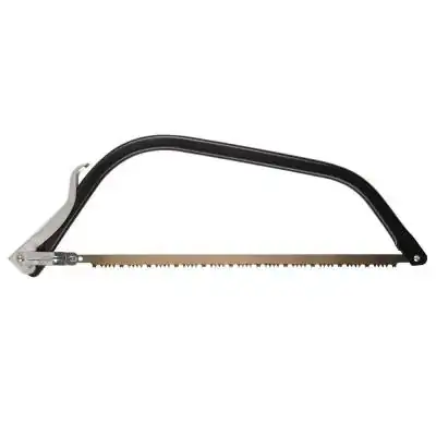

I always used a bow saw or pruning saw to trim my big and little palms. They will cut through anything. Not good for high stuff. Mine got so big I had to finally break down and hire someone to cut them for me. Not worth going to the hospital.
