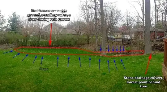

I just bought a house a couple of months ago, and like many suburban lots, the property has a drainage easement that runs along the sides. One side has a stone culvert pipe that moves water away from the property, the other side appears to have no particular drainage method, other than slightly sloping toward the culvert. The latter side is constantly soggy and muddy, with standing water, and it turns into a veritable river during rainstorms. I attached an image below showing the slope of the yard and the problem area.
I'm going to contact the county surveyor to see if they will do anything since the easement is not draining correctly (I don't see how it ever did in the first place - the house is 14 years old). But, assuming they won't do anything, is there a particular fix that works best for these side-property drainage easements? I've looked into french ditches, re-sodding, and laying perforated pipe - it's difficult to know which method has the best chance of working.

There are many native species that love water, and will work on filtering the water. Grasses/sedges are the easiest to get going and prevent exposed soil.
Following is a list of species available from seed from a wholesale public works grower in New England.
Lurid Sedge, (Carex lurida), Blunt Broom Sedge, (Carex scoparia), Blue Vervain, (Verbena hastata), Hop Sedge, (Carex lupulina), Green Bulrush, (Scirpus atrovirens), Redtop Panic Grass, (Panicum rigidulum), Tufted Hairgrass, (Deschampsia cespitosa), Tickseed Sunflower/Bur Marigold, (Bidens aristosa), Creeping Spike Rush, (Eleocharis palustris), Soft Rush, (Juncus effusus), Fringed Sedge, (Carex crinita), Square Stemmed Monkey Flower, (Mimulus ringens), Swamp Aster, (Aster puniceus), Boneset, (Eupatorium perfoliatum), Rattlesnake Grass, (Glyceria canadensis), Swamp Milkweed, (Asclepias incarnata), Common Sneezeweed, (Helenium autumnale), Ditch Stonecrop, (Penthorum sedoides)
