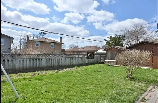

Edit2: here is a picture, the two sheds are not there anymore, that spot has no sod now enter image description here

As you stated you have several options. First, I'll answer a few questions:
do I need to do anything special when I use a sod cutter on this unevenly leveled soil?
No, specialised sod cutters cut through sod at a certain depth, which can be set low enough for most applications. If it doesn't get everything (very unusual) you can re-cut the area or use a sharp spade.
is the beginning of June a good time for this?
In Toronto, yes. Just make sure the new lawn is kept well watered until established.
To get my lawn back I can either buy sod or seed and wait for the grass to grow back. This should be easy with the wet summer that we are in for here in To.
Any pros and cons ?
Both should be equally successful if done well, with the sod being faster, at a cost. Both can be a great lawn, and in a year or so of good growth, differentiating between them isn't often possible.
About your two options: cutting the sod, regrading, and replacing the old sod, and your other option of rototilling and reseeding/sodding, Here are some pros and cons for each:
Method 1, cutting the sod:
  • That doesn't look like the greatest sod; I wouldn't reuse it, but you could if you want. Just mow it off rather short beforehand.
  • If you want to add new sod, this is the best option. It also makes it easiest to regrade.
  • If you want to seed, this is a good option also, although you will have a pile of composting sod sitting by, and the lawn level will be lowered.
Method 2, rototilling:
  • Green grass decomposing in the soil has allelopathic qualities which inhibit/retard the growth of new grass, especially seeded.
  • This method keeps all the topsoil in place
  • You will likely need to regrade after complete decomposition, because of shrinkage and settling.
Other options:
  • Kill the lawn by herbicide or tarping, then regrade and replant
  • Use new soil to fill in the uneven areas of the lawn, and then overseed
In any case, you won't go wrong by adding compost to the soil. It would also be a great time to do some testing and find whether your lawn could use lime, etc.
