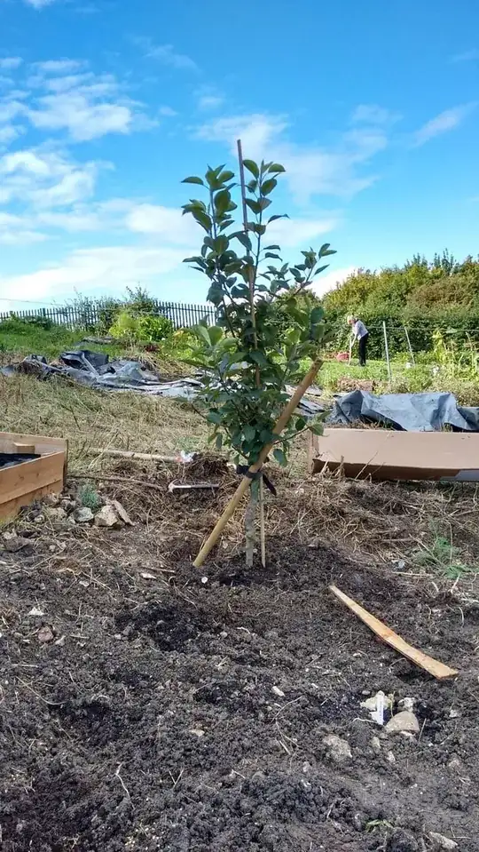

Today I planted an apple tree grown on dwarfing rootstock (M27). The soil at my allotment is very heavy yellow clay. But it's on a decent slope.
I dug a hole the depth of the container in which it came. The bottom of the hole was practically hard clay, you could make sculpture out of it. Therefore I did the following:
Put in some big stones. Then compost, fish blood and bone and horticultural grit, all mixed together. Planted the tree and the stake.
I fear that the tree roots might get stuck in the clay "ball", and that the drainage might not be as good as needed.
Can someone give me any impressions about this, and in case it seems it's doomed to root rot, is there anything I could do to prevent it at this stage?
Below you see a picture, and I am in Bristol, UK.

Edit: Now we have a picture I would recommend that you:

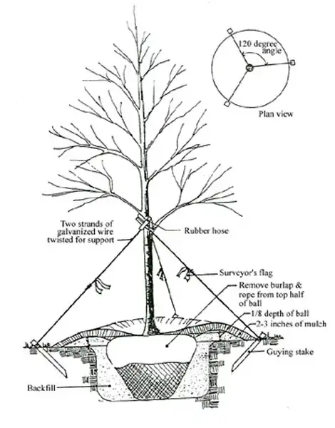

  • follow the staking practices in the picture. Use three stakes instead of one. - with the slope you have I doubt you will have wet soil in the spring

There is no easy answer here, firstly I would question why in the location shown in your picture have you chosen such a dwarfing rootstock? This tree may not flourish here. Firstly I would dig up,the tree and remove the stones as they will just make things worse. Clay is impervious to water so the hole you have dug will just fill up with water from the slope. Consider if you just dug a hole here it would fill up with water as you have created a sump. Digging a bigger hole and incorporating a lot of organic matter may help but you still have a potential hole full of water. My advice would be to plant in as small a hole as possible without improving the soil as already advised above and try to engineer the surrounding surface soil to divert water away, sealing the hole with clay soil but not covering the graft, the tighter the fit the less standing water will enter the planting hole. If the tree gets established It would do quite well. As advised keep it well supported all its life and good luck.

Eek ! If this were my tree I'd carefully remove the whole bolus of the tree from the ground now, as carefully as possible, in order to save it from the dreaded root rot.
You are absolutely right to be concerned about the drainage issue, even though there is a slight slope. I've lost trees on a slight slope but they never had sculpting-style clay close to the rootball. In other words, my trees had a healthier prognosis but died of wet feet in a long wet spell anyway.
Please, as tree-lover I say, gently remove that lovely tree and put it where the roots are cool and moist while you go to work to dig a much deeper and wider hole for it. Then put layers of organic material and the original (not sculpting-clay though) soil back in the hole. Gently replace the tree, asap, in a 'cup' in this larger planting hole. BUILDING THE SOIL SURFACE UP TO A GOOD ONE FOOT ABOVE the surrounding soil BEFORE replanting the tree. Firm the area down a little, then, stake firmly, (3 stakes), and always keep a mulch on the roots.
If the tree shows signs of wet feet (drooping, yellowing, water sitting around it) either dig a runaway down the slope, and/or dig the whole tree up and out of there to save it's life. Then, replace it in a day or two but sitting even higher than it was before. You will always have to keep an eye out on how its doing, in order to prevent death by wet feet. Location, location, location ! All the best ! Voice of experience (with fruit trees growing in clayey soil).
