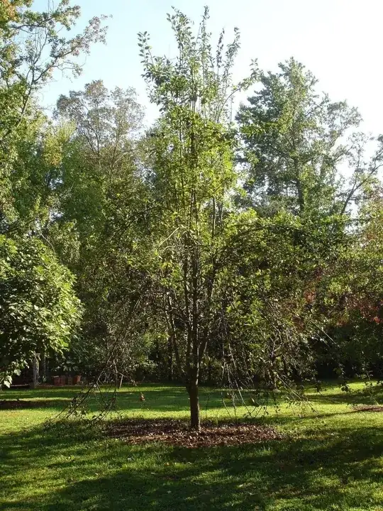

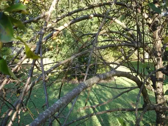

I have a pear tree, which is very zealous. Whatever it decides to do, it does in excess. First in the spring it sends out all sorts of new branches--all of them vertical. I snipped them off after they grew a few feet, but they merely resumed their skyward climb for 10 feet! Then the pear tree flowered and produced tremendous amounts of fruit. All the branches bent over more than a bow and arrow bends. Some of the branches literally snapped under the weight. What can I do to help this poor tree?

From what I can tell from the photos, it looks like this tree doesn't get full sun -- it looks like there are other trees that might be slightly shading it. This could cause some of the vigorous vertical growth that you see -- it's trying to get up into the sun. (I say this more for understanding than for anything you can do about it, short of cutting down some of the competition...)
In your circumstance, you want to do a summer pruning rather than a winter (dormant season) pruning. The dormant season pruning will stimulate more vigorous growth, when your goal should be instead to open the tree up to let more light in. Just don't prune too late in the season -- since any pruning will stimulate growth, you don't want fresh green growth to be exposed to winter chill. It's best to do it in early/mid summer so that the new growth has a chance to harden off before winter.
Your goal should be to establish "scaffold" branches (these are the main, roughly horizontal branches). There should be about 4-6 distributed evenly around the tree, about 4' in height vertically from one scaffold to the next. (Imagine that you have four scaffold branches at a height of 6' pointing north-south-east-west, and then another four main branches at a height of 10'. I just picked 6' and 10' out of the air -- use what works for your tree.)
If you are trying to control the height, you can cut back the central leader to just above the top scaffold.
When you do have to remove lateral branches, cut them back to the trunk. (Using the scaffold example mentioned above, imagine that there's an extra lateral branch pointing northeast at 6' high, and it's 5' long. Don't just cut it back to 3' long, cut it back where it comes out of the trunk. If you don't prune it all off, it will just keep growing with several extra small branches pointed in that direction, and they'll interfere with the scaffold branch. It looks like you have a few lateral branches that have done exactly this.)
The general pruning advice given in Mike Perry's answer is good, though I'd recommend removing any downward-facing branches. These don't help anything, and they're more likely to break when loaded with fruit.

Advice, observations from looking at those 2 photos you've posted:
Remove limbs that cross (rub against each other) ie Remove one of the limbs, so that two limbs aren't rubbing against each other.
Relieve the weight on some of those "downward" branches by shortening them.
Remove (cut-out) some of those "downward" branches.
Reduce the height so it's in scale with the overall shape of the tree (this will need to be done over the course of a few years).
Thinning the fruit each year will greatly help reduce the overall stress on the branches ie Will prevent the branches from sagging too much under the weight of the fruit.
Before wintertime arrives, cleanup the "orchard floor" ie Rake up all the leaves and pick up all the fruit from the ground underneath the tree(s), doing so will help prevent diseases from overwintering in the ground under the tree(s).
- It looks like you have a good size "tree ring" (cleared area) around the base of the tree(s), once you've finished clearing that area (and the surrounding area) prior to Winter, lay down a 2inch (50mm) thick layer of mulch. Personally I would use good quality compost, start approx 4 to 6 inches (100 to 150mm) away from the trunk of the tree(s) and work out to the edge of the "tree ring". Using compost as a mulch in this situation has the added benefit of feeding the tree(s) naturally and slowly. Then add a fresh 1inch (25mm) layer every year after you've cleared the "orchard floor".

What I did on a apple tree in this type of trouble was cut off the thinner branches, leaving the vigorous sturdy shoots. Then I topped them off at the third main lateral. This slows the tree down and increases the height. Also try to keep the branching thin and airy, and keep the branches that slant down trimmed off to improve the structure.
