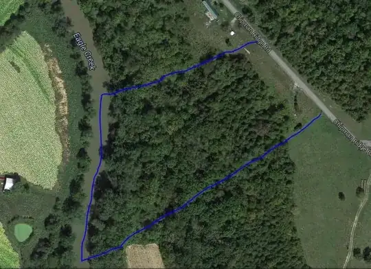

We are purchasing some land in northern KY. and want to start growing food in the wooded area. We plan to plant ginseng but beyond that we are looking for other suggestions as to what we can grow in this thick woods. Very little undergrowth, older forest with a creek near by. Lower level floods in the spring for a short while so that could be helpful with certain plants. Mostly hardwoods, in hardiness zone 6b.

Another consideration is to clear some of the land. Your photo looks like a fairly mature forest. You could clear half to 1 acre clearings. One acre is several year's fire wood.

Where you will have an opportunity is at the edge of your woods on the upper right side of the photo, and possibly along the creek. Many fruits and veggies grow very happily in the margins.

In the summer, everything uphill from the creek will become very dry, and the food crops (especially those yielding fruit) will need irrigation. You will find more underbrush near the edge (up by the road). If you clear that out, the edge biome will have a much more diverse set of options. And the grassy strip at the top will grow quite a lot.
