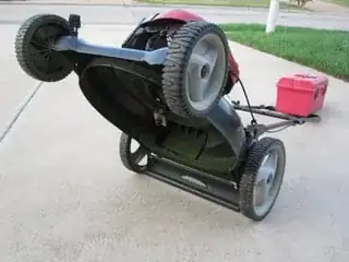

  • Now the lawnmower needs to be "laid on its side" so the blade can be removed. The trick I use (prevents petrol/gas from leaking out of the tank), is to tilt the lawnmower backwards and place a heavy toolbox on the handle to prevent the lawnmower from coming back down. See below image (click to enlarge)...

  • With the lawnmower "laid on its side" or tilted back, wedge the scrap piece of timber in between the blade and the cutting deck so the blade is unable to spin.
