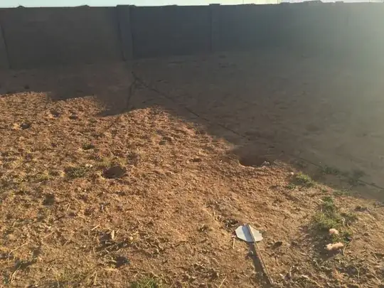

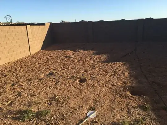

I moved into my house back in December of 2015. We still have a dirt yard and want to try and get something in before summer time.
I have had a few quotes that are a little out of budget for me so I was thinking about taking this project on myself and then anything I cannot do I save up for and have done professionally (possibly cement).
My yard has a slight grade at the retaining wall going towards the house. The front left of the house is where the draining areas are on the bricks. That is the direction that the yard is flowing towards.
My question:
Since the yard is pretty tough right now, with a few holes from the dogs digging, what would be the first recommendation in terms of leveling out the yard?
Do I need to till the yard to break up the hard dirt and then screed it out and make it level?

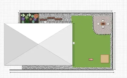

I will be adding in sod, rock and eventually a cement area for seating/fireplace.
I am just trying to figure out how to give myself a good starting area.

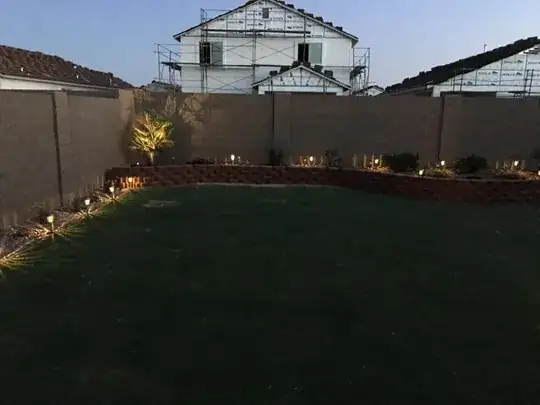

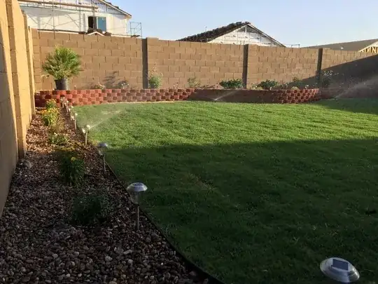

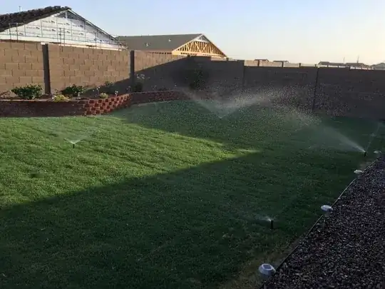

UPDATE
For those who care to see what I ended up doing, pics are below. Also added a citrus tree in the middle of the back wall (not pictured). Most difficult part of the process was getting the ground level for the bricks, the rest kinda fell into place. AZ dirt is a pain in the ass, especially for the trenching, the machine struggled :)
SBB

The ground looks very compacted, so first step would be to aerate and loosen the surface. Some easy tips here: http://www.gardeningknowhow.com/garden-how-to/soil-fertilizers/improving-compacted-soil.htm
Is the block wall around the perimeter of the yard retaining any soil behind it or is it there for security/screening. If it is retaining I would do some more investigation before trying to direct the overland flow/drainage. Otherwise the key is to make sure the ground falls away from the building, so creating a simple swale to direct the overland flow away from the house is probably going to drive the design.
Viv
  • 921
Use the link from the answer above as a good starting point. Do any hard landscaping e.g. paving, paths first. As long as it doesn't impede access for any heavy equipment you may need. All prep now will pay dividends later on. Get the soil right from the start and any plants and trees will establish better, quicker and strongly. That will reduce losses of sometimes expensive plants purchased. I don't know what the building industry is like where you are, but generally in the uk, a lot of contractors will scrape off the top soil (with the nutrients and humus and organic matter) before construction and retain this. The subsoil left behind becoming compacted from the construction. Some less scrupulous will leave rubble and rubbish and bury this, before turfing over it. You at least don't have that one to sort. I don't know if what you have visible is the top soil or the sub soil. It looks from the picture to be quite sandy. If you have sub soil only, hire a rotovator and ensure that to a depth of about 18" there is no compaction. Levelling as you want to. Then you will need to import top soil (from a reputable source to ensure there are no noxious weed seeds in it) and then use this for any cultivation. If top soil is present, take care not to dig this into and under the subsoil. In any event add as much organic matter as you can. Test the soil for pH and nutrient deficiencies. Remedying this to start with. Then start your gardening. Take care to put the glasses in the fridge along with the drinks, to enjoy the fruits of you labour.
