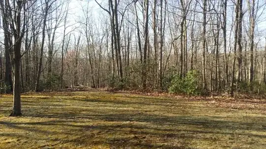

We just bought 28 acres of land with a 30 year old existing house in the center on about 1 acre cleared, the rest is completely tree filled.
There is a natural slope only a few degrees heading from the back of the house towards the back yard, downward. About 100 feet back is a large drop downwards that goes out for at least 1000 feet and down about 150 feet. It is at least a mile or so of very slight downgrade to the nearest neighbor behind that.
As with most houses in my area, the ground stays slightly wet until late March because the "water table" is only 1.5-2 feet below the surface, because my yard is almost 100% clay with hardly any topsoil and very little grass, mostly moss. This confuses me that the water doesn't follow the slope downwards and away from the house. My guess is that it can't travel horizontally through the clay even with the downgrade.
I want to make a level yard with nice grass and no water issues. This requires me to put a lot of fill towards the back of the yard to level it (because of the natural slope).
The yard will be about 150' wide by 80' long from the back of house.

This sounds like a lot of work. The picture you show of the backyard looks nicer than some other lawns I have seen where people have a maintenance firm do the fertilizing and cutting.
