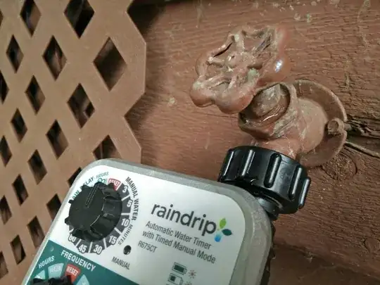

My garden hose faucet leaks out of the valve knob center whenever it is on. leaks out of the valve knob center. Can this be fixed? How?

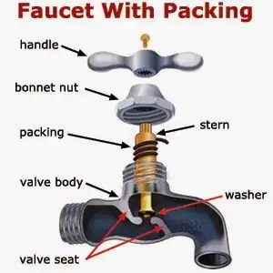

You need to replace the stem packing. The stem that the knob is affixed to the end of is sealed with a packing nut which has either a packing washer or a quantity of packing material under it.
You can buy "string packing" at the hardware store. Loosen the packing nut and jam a few loops of it up under the nut, then tighten it back down.

Cute! Love that old faucet. Have you tried turning the water off at the street, disassembling this faucet and using plumber's tape on the threads? Otherwise, get a new faucet! Depending where you live you might find a stand alone faucet called frost proof would be a good idea to install. Not tough to do at all. Otherwise, looks like you could screw that old head off, scrub the rust off and use plumber's tape. Great great stuff!
