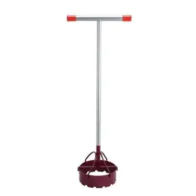

I would suggest getting a donut sod cutter or a Sprinkler Head removal tool.
They're designed to cut a small hole around the sprinkler head to allow easier access without having to dig up a big area around the head.
sod cutter

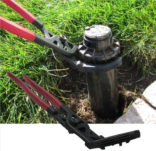

You can also get a sprinkler head wrench to help free the head from the pipe.
You could get away without having the wrench if you have access to a pair of channellocks, but, the right tool for the job always makes things easier.

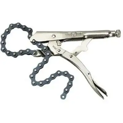

If you don't care about the ones you are removing (because you are removing them to replace them) Chain Locking Pliers would also be an option - more robust, more prone to damaging or marking what they are used on (intended as an example of the type, not a specific recommendation of brand or store):
chain locking pliers
