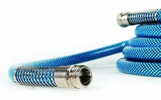

Look for "Lead Free, BPA free, and phthalate free" hoses, often marketed for RV's, boating, and camping. I'd avoid brass fitting for the metallic taste alone. If you want to continue using your current reel set-up, consider adding a filter, such as "Camco 40043 TastePURE Water Filter with Flexible Hose Protector," which over 12,000 Amazon reviewers seen to like.
