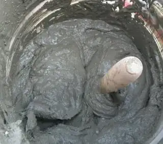

  • Either use ready-mix bags of brickwork mortar or mix your own.
    • If mixing your own, measure out the materials by volume (use a bucket), doing so will ensure you achieve a consistent "finished" mortar colour.
    • Mix strength by volume of materials, 4:1 or 5:1 ie
    • 4 or 5 parts soft building sand.
    • 1 part Portland cement.
    • Thoroughly "dry" mix together the two materials.
    • Add a suitable Mortar Plasticiser to a bucket of clean water -- this will make the mortar more workable, easier to use.
    • Add the water (with plasticiser) slowly to the dry mixture, mixing together as you go -- you want to end up with a thick (but workable), lump free mixture (see below image, click to enlarge).
