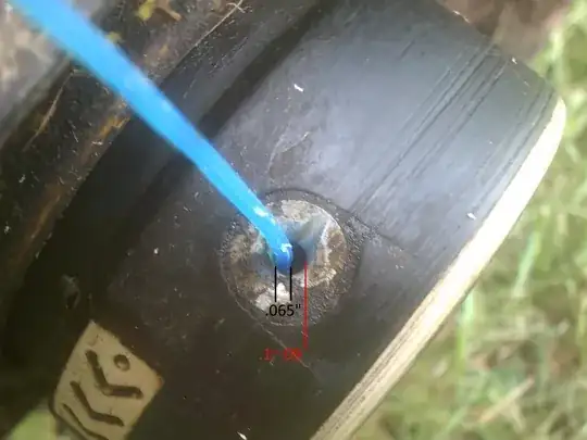

I have a Ryobi P2200 hybrid weed whacker. It takes .065" (1.651 mm) trimmer line. I have found better deals and much better shaped line. I have found a piece of (plastic) wire that was exactly .08" (2 mm) and fed it through the hole and it fits with some room left over (did not run with wire in, very dangerous!).
I would naturally think there is a great possibility that it would work. But would there be a reason why it does not say in the manual it can handle .08" (2 mm)? Will it mess with how it auto feeds, how it performs etc. Would it be worth trying? Not that I go spend $8 at a local store and it does not work.

It looks like it could fit (in a pinch). I have successfully used different guages of line on other weedeaters (although I have never used this particular weed eater). So I'm just going to list some of the possible pros and cons.
Pros
  1. 0.08" is commonly available, and might be cheaper (by the foot) in some areas.
  2. Thicker line should be more durable; so if it's about the same price, but it lasts longer, it would be generally more economical.
  3. Trying will not cause the weedeater to explode.
  4. knowing whether or not it can use a different string will be handy for future reference (it's better to test it at your convenience than when your options are limited).
Cons
  1. Thicker line might require more power to move/cut through weeds.
  2. Thicker line will be shorter on the spool (in other words, you might get 6 ft of 0.065" line on the spool vs. 4 ft of 0.08".
  3. Feeding thicker line though the hole (especially during operation) might be a problem, causing snarls.
  4. Heavier line might cause vibrations (which can lead to a bent rod).

My dearly departed Dad left us a spool of .080 the size of a battleship gun round, so this should last us our lifetimes! LOL. Our pootie little Ryobi 18V weed-eater bit the dust, so we got a 2nd hand 40V Black & Decker that cautioned "only use .065 line".
Well, our donor also gave us pre-wound spools of that size, but I could not rewind the empty ones with the thicker plastic line, so I awl-ed out the keeper hole and slot to accept it. Tried it and it works absolutely fine! I did Dremel sharpen the cutter blade on the housing after a nice scraper cleaning.
BTW & fyi, those pre-wound spools are kept in place with reinforced packing tape, so it takes longer to remove that mess than to simply wind your own, like I did from dear ol' Dad's "barrel-O-trimmerline"! Hope that helps Y'all.
The reason we all need a clean and sharp cutoff blade on the housing is because otherwise it will "gum" the line, and sling out more of it until inertial forces pull wasteful amount of material out of your magazine. Sorta like eating corn on the cob with no teeth. Apologies in advance for being a nerd & an engineer.
