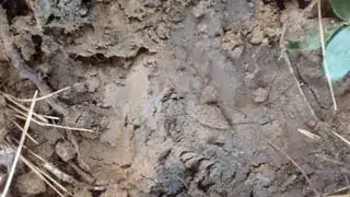

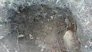

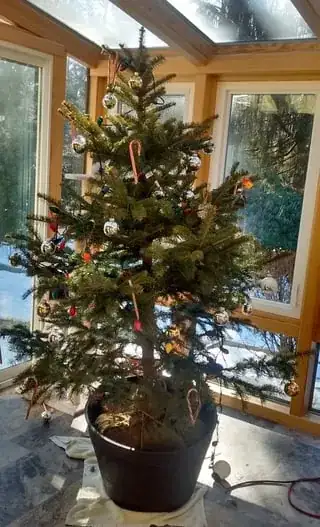

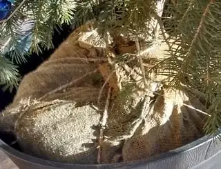

The pictures are of the tree inside; a close-up of the root ball in the pot; the entire planting hole; and a close-up of the bottom of the hole. The soil in the bottom of the hole seems clay-like. It's thick and slimy. It almost feels like mud, just not quite as wet.

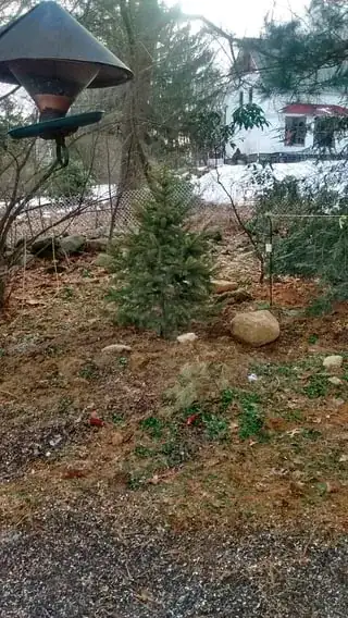

Update: The tree is fine!
My husband planted it on the 11th day after it had been dug up. He did it by combining the advice from the arborist from whom we purchased it, the generous people who answered me here, and this excellent question/answer. He unfolded the burlap gently. It had no nails and no mesh bottom. Since the rootball was moist and holding together nicely, he removed the entire burlap. Without watering the hole, he gently laid in the tree at the proper depth, and backfilled it with the dirt from the hole, together with some other loose dirt and crushed leaves. No needles dropped and no branches fell. We're glad we didn't water it, as it rained the next day. We had our first deep frost that night, so the timing was perfect! It was a wonderful experience all around. I encourage people to use this method for their Christmas trees. The tree costs much less than it would from a regular nursery; adds to the landscape; provides a great place for birds and squirrels; and doesn't become a side-of-the-road casualty.
I didn't get any great pictures, but for reference as to location, we put it exactly where last year's pre-cut (not planted) Christmas tree was just sitting dead on top of the ground! More pictures of the area can be found in my previous question.

Based on the picture, your soil looks quite moist enough already. By watering, you could cause problems in winter with constant saturation, because of the ground freezing. I'd say, if the soil holds its shape when squeezed into a ball, do not water. If the soil is crumbly and dry, then yes, water it even in winter. Sometimes I water a root ball before planting, because the root ball is dry and the soil it's going in is wet. In your care, the root ball has been kept moist so I also do not see any watering necessary.
