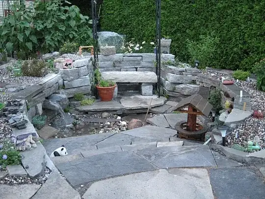

I have an olive barrel/reservoir/water feature that is completely buried underground. The pump is at the bottom of the barrel which is approximately 4 feet underground. I drain the reservoir in the autumn. It is full of water every spring. So far, in our zone 5 location, where temperatures of -30 deg C are not uncommon the barrel and pump have come through fine since being built in 2008.
If you are really worried get a cattle trough heater with guard from a feed store. That will keep things liquid at the cost of some electricity.
