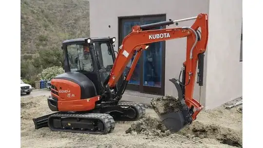

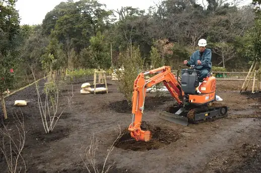

Alternate tool of choice - an excavator. They can be rented, or you hire someone who has one and knows how to use it.
excavator tiny excavator
