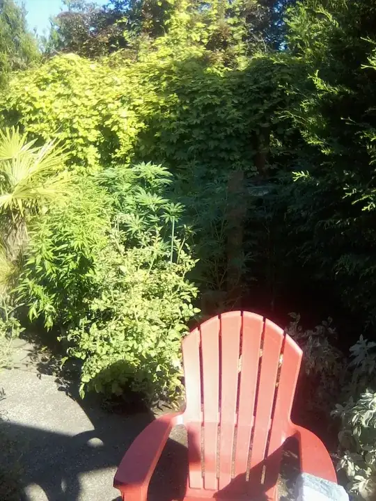

There are 3 I'd recommend; an evergreen would be Clematis armandii, white flowers, tough tough plant and fragrant, wow fragrant. Another would be Akebia quinata; mine in zone 5 was evergreen. Akebia quinata Yummy to walk beneath if that is possible, such as a gate. Profuse yet dainty purple flowers. The third is a perennial that will grow 25 to 35 feet every season and die back for the winter. You will be able to rip all the old/dead Golden Hops in back growing up into treevines off the wall in winter or spring and never have to do any pruning. In the spring, this plant takes off and I swear you will be able to watch it grow; 2 or 3' some days. Golden Hops...Humulus lupulus 'Aureus'...the new foliage is chartreuse, bright lime green. Later in the year leaves become dark green. Gorgeous little 'japanese lantern' flowers. Was my favorite. Choose your own variety to harvest and make beer.
