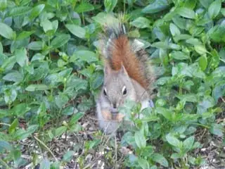

  • It's a vine, so it reaches out in any direction it can. It also bunches up if it has no place to go. We've been here three years and have never needed to prune any areas of the main carpet. The vines along the border, like where the young squirrel is in one of my pictures, will reach out between two and three inches at the most over the course of a year. It's very easy to break, though, and is shallow-rooted, so if it starts to get in your way, you can pick or cut off the ends, or pull entire vines out, including the roots. The other thing I do is just turn the branch around and tuck it back into the larger area. It will re-root that way, making it even more care-free. Speaking of shallow roots, it transplants very easily. As long as it's not actively flowering, I pull pieces up and plant them in my window boxes. With some steady watering they take hold quickly and, after creating a blanket around my other flowers, I can train them to grow over the edge and become a trailing vine. (As I said, it grows slowly, so if you want a long training vine in a hurry, it's not the best choice. I know you didn't ask about this part. I just added it to show its versatility.)
  • It can definitely take being walked on. We keep it under our bird feeders and don't think twice about stomping on it when feeding the birds. Chipmunks, squirrels, bunnies, skunks, opossums, raccoons and occasional passing young bears also trample it, but it doesn't suffer. It pops back up within a day or two. It also has no problem handling heavy snow and ice. You didn't mention it, but in case you're wondering, none of the backyard visitors eat it. It's also a safe spot for chipmunks and squirrels to hide. We have a rabbit that breeds under the rhododendron, and when the babies venture out, they use the vinca for cover.

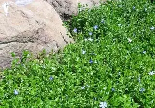

  • It grows along the base of our stone wall border, but doesn't really climb it. You mentioned you'd prefer a different plant there anyway.

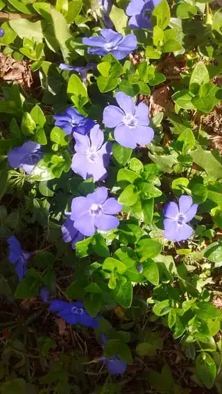

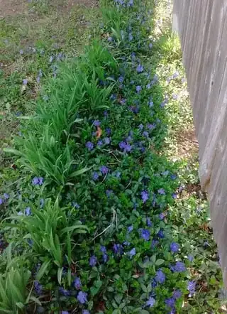

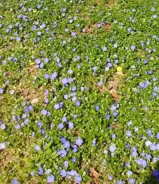

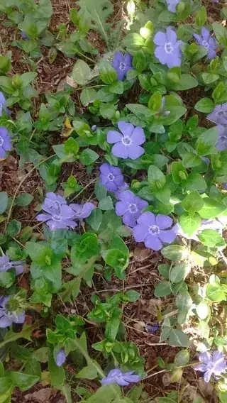

Edit: Above the vinca pictures in the original answer, I added some that bloomed in May. They're from all over my yard, in sun, part sun, and shade. Some are out in the open; one is under a blossoming bleeding heart which is under a rhododendron; and one is under some miscellaneous plant debris left over from last year which I didn't clean up! The only two that are not mine had been in the original answer, with links to their sources.
All of the pictures have been made smaller so as not to take up too much room. Click on them for larger, closer views.
Flowering in sun under bleeding heart Flowering in shade Flowering in mixed shade partly under rhododendron Flowering in sun enter image description here Full sun with dandelions In shade next to hostas along fence My baby squirrel with astilbe
