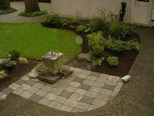

I have paver bricks with this cracks between each brick and weeds.
Handling the weeds is a challenge for my wife and I.
Any suggestions?
Our strategy now is:
  • hand pick the weeds
  • use a power washer
  • fill the cracks in with locking sand

[paver install with cmu walls[![][1][1][1]These pavers have spaces between individual pavers? One thing you might do is redo the entire patio floor so there are no spaces. Need to send a picture of paver type and paver bed; how deep is the sand beneath, the gravel beneath that?
This will be almost the same amount of work that you are considering pulling the weeds. If there is no proper bed I seriously would pick the pavers up and make the correct bed. You'll need to rent a compactor, dig out the gobbeldygook, install 4" of 5/8 minus gravel, 2" of mason sand on top, compact well in layers. Then you begin to reinstall the pavers butted up against one another, no space at all. You'll need string and a 2X4 and one of those big soft hand mallets to tap an entire row tightly to the last row. Keeping a string all around the perimeter that you have leveled as the top of the patio. Using that string and the 2X4 and tapping complete your patio. The plastic edgers are nailed into the ground and hold the pavers in place. Big 8" long nails. Spikes I guess more appropriately. Your building materials place will have everything and people to help you.
By butting the pavers up together REDUCES the chance of weeds but will not stop weeds. Using the pressure washer one a year will. I am hoping these pavers are 2" thick and untreated concrete...
If your pavers are thinner then that sandcrete would be a good idea. 2" thick CMU pavers look terrible done with spacing.
The most professional paver look is without any spacing. If you are going to do so much work anyway it would be almost easier to just redo the patio and make sure the job is done right. A GOOD paver patio/driveway ADDS big value to your home! Please send a picture of what you are dealing with first, how large and what is the condition of the bed?
