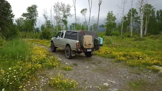

A tree that extends more than the length of the pickup truck box is going to be a challenge unless you can get a larger truck with a box. If you do this a lot you may want to consider such a truck. Or possibly buying or constructing some sort of wind break box to go on the back of your pickup. A simple canvas or plywood construction can quickly be put in and removed. Here is just one example to get the idea of what I'm talking about, but you can quickly Google moreenter image description here.
https://www.tacomaworld.com/threads/diy-soft-topper-ver2.561502/
You could consider making it extend somewhat past the back of your truck. Depending on how "handy" you are and what storage you have available, you could get more or less ambitious.
In theory you could even remove the top, load the tree, put the top back on, drive to destination, remove the top, unload the tree. That gets the top out of the way to get at the tree.
