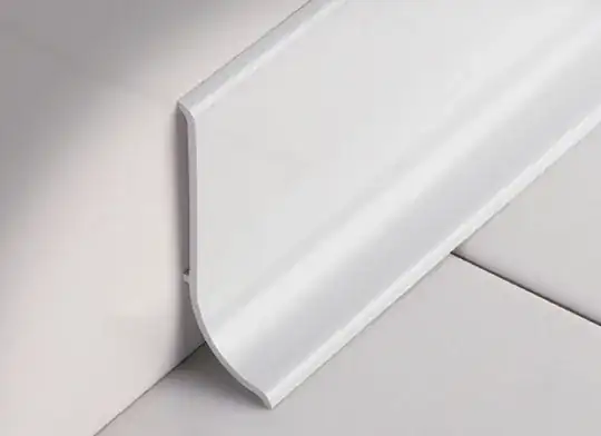

Why not add a drip strip to the bottom of your railing? Depending on the width of your balcony, it should only take a few pieces of coving attached to the base of the railing, having the curved part resting on the ground and sealed with a thick bead of clear silicone. coving Any run-off or spillage will be stopped by the barrier. After draining has finished, take a super absorbent towel (like a sham-wow) and sop up dirty water in probably one pass. The added benefit not only of your neighbor, but a cleaner outdoor area for you.

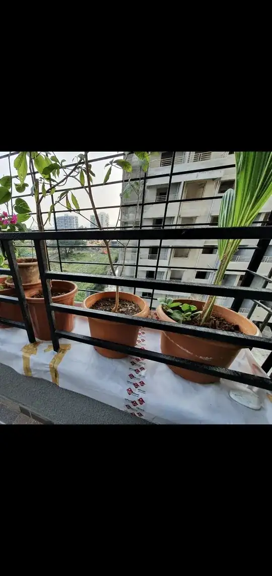

After giving it a lot of thought, I came up with the cheapest idea.
I used old banner from streets and cut it the way it fits on the area which will shape as a tray.
I hope it will last for min 3 years at least.
WIndow tray made from plastic sheeting
