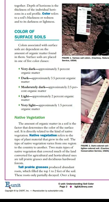

I am including the link where I obtained this information. This site is FULL of soil info and how to understand your core samples. Let me know if you cannot open the link. Also check out pic below link!
http://practicalbio.blogspot.com/2011/07/soil-color-why-is-my-soil-red-or-tan-or.html?m=1
Screen shot of PDF from above link, showing color chart soil descriptions
