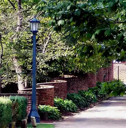

I've seen the ones at UVa but they were all too high for sitting on as far as I recall.
So, can these walls bear the weight of a few humans?
UVa walls

A linear brick wall is strong in compression but resists lateral forces poorly. The serpentine wall attempts to overcome that with its curvature so that it provides as much strength as a linear two brick wall but uses far fewer bricks to build.
However that strength comes at a cost in that the convex portions of the wall are strong, but the concave portions are weaker in resisting lateral forces.
So it's likely to support several people at a time, but they should mount and dismount from a convex surface.
There's another practical issue in that it's much harder to construct than a linear wall since you're not following a string line.

Yes, a Crinkle Crankle Serpentine wall that has no other job to do such as hold back soil and is only 15-18" high, has a decent foundation of compacted gravel and a foot deep concrete foundation and the units are mortared together will be able to support human weight...you won't need to double it at all unless you actually want people to be comfortable, have a place to set their plates of food and drinks. The difference in price for a crinkle crankle serpentine double wall and cap and a cmu garden wall not including the labor to construct a serpentine wall is huge. I'll go check out the difference but I'd still need more information; drainage, surcharge, how to get a 'cap' on a small serpentine wall only doubled (or spaced with fill inbetween). I am guessing a small serpentine wall with custom caps, doubled walls will infill will be at least 3X more expensive. You could hope for a 1' wide wall. Concrete masonry unit (CMU) is 2' by 2" by 2' in length each.
The simple answer is yes, that wall as long as it is mortared can be used for human butts and weight. Good luck anyone would chose to sit on that wall without a cap.
And even a serpentine wall done well will enact a straight line. Otherwise, you could go nuts with erratic radii, a curved line of build that is also erratic. Just do the foundation correctly, allow no surcharge or build up of soil on one side making this a free standing nonsensical crazy wall to go with your free form home.
