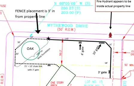

I am considering having a total 210 foot run of 6 foot high serpentine wall built out of concrete block, brick, or a combination. Made up of 100' of wall + 4' gateway + 30' of wall + 10' gateway + 40' of wall + 3'gate + 10' of wall. The longest run is east-west and 60 feet runs north-south. (I just realized that the maximum run of wall between gate pillar/posts is only 100.') Prevailing winds from north or south-east; generally light, but gusts up to 70 mph in storms. Huntsville, AL; flat, heavy, clay soil. Drainage will be addressed. I want to avoid disturbing the soil as much as possible. I am considering using a foundation of one solid 4" concrete block on top of 6" of sharp paving foundation so that the concrete block comes just an inch below the ground surface. I am considering that the opposite apexes of the wall will be 3' deep and the radius of the curve is 6'. This equates to using 8' wall sections to make a zig-zag inside a 3' width. Is the proposed foundation adequate? I will have to get the city engineer's approval.
