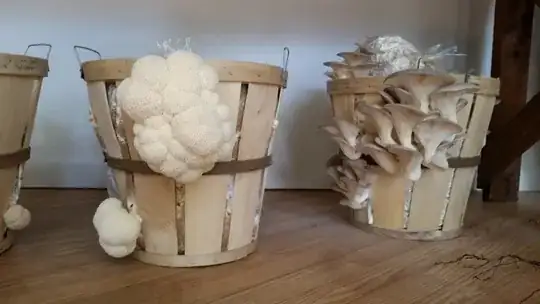

  3. I have had pretty good results with lion's mane (and various oysters) using the non-sterile method outlined by Dr. Rush Wayne in his detailed booklet "Growing Mushrooms the Easy Way." The photo below shows the results of one of my early grows on un-supplemented hardwood pellets using Dr. Wayne's peroxide method. Those are small baskets lined with thin plastic bags. They contained about 12lbs of substrate/spawn at a ratio of about 1:10 or so. This required no sterile technique, no special equipment, and the substrate was just hardwood fuel pellets with a few tablespoons of gypsum.
