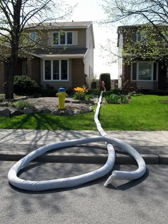

  • when in doubt 4" diameter drain pipe with sleeve is your friend. Cheap, durable and works for you all year round. Where I live winters are now snow, melt, snow, melt. Frozen ground does not drain well so drain pipe helps. Bury parallel to the house in a 6" deep trench and slope towards a french drain at least 12" deep, preferably 24".

  • if you have gutters direct them directly into your drain pipe so they have a good ten or twenty feet to run before hitting your french drain
With the right build up your drainage works can be a festive occasion for all members of the family.... four inch drain pipe with sleeve
