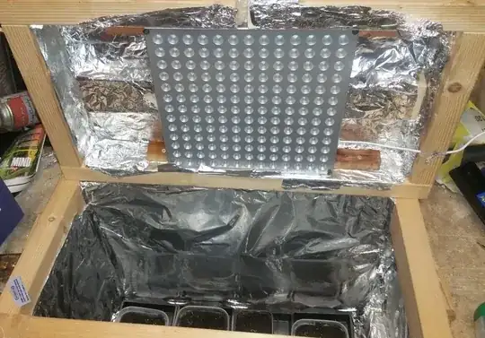

After a few weeks sitting on a heat map they started to appear. It was at this point I turned the grow lamp on for 12hrs a day as well with the lid down:

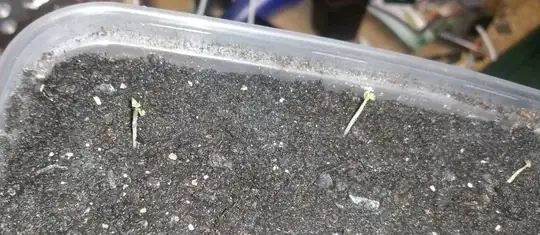

My Seed container
I watered once a day keeping the soil damp, but once the seedlings showed their first two leaves they wilted and looked pretty much dead or dying:

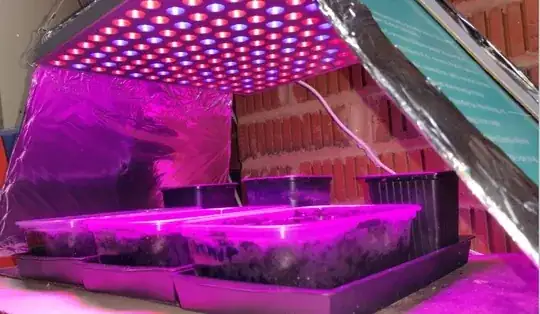

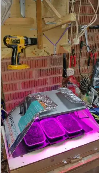

Thanks for the comments guys, I've updated the setup now so that the seedlings (what's left) are outside..I have the grow light on from 0700 to 2200 with the heat matt coming on at 2200 to 0700: enter image description here enter image description here
You have cooked your baby plants! Get rid of the box, if you are growing indoors you do not need a heating mat. You do need thermometers; for soil and for the air. You will need to get a great fan to blow air. Easy to begin again.

You could bake bread in that box. I use a horticultural heat mat on a timer for 8-10 hours starting at midnight. The ones I use range 24°C-30°C and are thermostatically controlled to adjust with ambient air temperature.
Full spectrum LED grow lights, 1200 Watts set 40-60cm over the soil surface, timer as well set 12 hrs. ON beginning at 0600 - as much as an average Spring day cycle. The average room temperature is ~20°C, could drop as low as 10°C. LED’s are much hotter than many suspect.

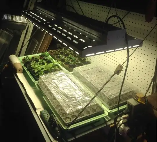

Thai peppers in upper left tray - typical starting setup w/white LED
